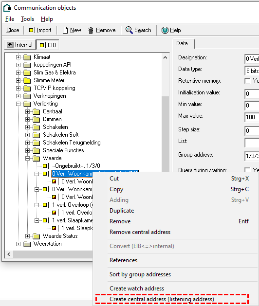

Re: Display status of shutter in QuadClient
Hello TP,
You need to link this in 'Communication Objects'
you can add a listen-groupadress to another groupadres.
see picture
listening adress.png (15.75 KiB) 12318 keer bekeken

Hi Dré,
Hi Dré,
i've try your solution and and it works perfectly.
Thank you
Remember that this also applies to the dimmers within Quad Client.
They will also just have a switching and dimming object to connect, both will require the same step as posted by Dré
